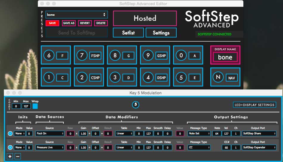

Soft step 2 does not send midi nots and velocity pressure together like most drum pads. However I can get it to send each separately could I use this translator to see both midi note and cc velocity and merge them and out put them together to work like a drum pad?

What kind of messages does it send? Is it a Note with velocity followed by a CC message?

This is what I got the midi set up to do sends note 64 with fixed velocity and then along with that sending a cc with the pressure I attached a photo

So for this, What we can do is change the CC message to a note message. You'd still need a translator for the Note, or connect a virtual connection in the router to pass the note through, then the CC will replace the note value.
Let me know if this works.
Code: Select all
Translator 1: CC Value
Incoming: MIDI Message
Channel 1
CC - 60
Any Velocity
Rules: None
Outgoing Message: MIDI Message
Channel 1
Note 64

That did not work I got it half working
midi message in cc value assigned to a variable 00
midi message out note on set note and i set velocity to variable 00
now I'm getting a note out and a velocity but it fires my drum pad a million times as the velocity will start at zero then go up and go back down to zero
I need to be able to assign the max velocity of the drum pad hit and send that out with the note.

When you press the pad, what do you want to happen? I was under the impression you wanted a fixed velocity every time the CC triggers. Do you, instead, want it to always send the max velocity when you press? And then what does the CC message need to do?
