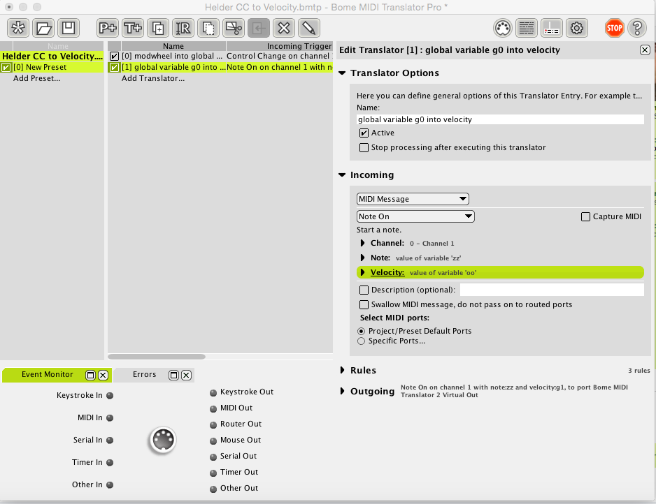

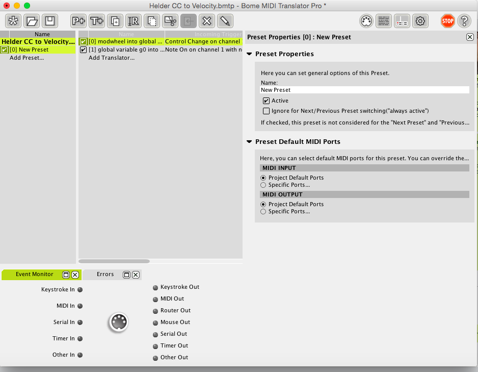

I am trying to make this work but I can't...I am inputting exactly as you explained but I can't get it to work. The event monitor accurately shows that modwheel data is being sent into the "other out" port (which I think is correct) but no other data goes from my controller to the plugin...no midi notes, etc. If I set the controller to route directly to the plugin via the Bome router then it works but it does not translate the modwheel data nor does it block velocity data...it is like it is plugged directly with no translation...
Could it be that the g1 variable is undefined?? Could it be that g0 is not picked up by the second translator??
Please help...:) I am new to this but I really want to make this work...
I attached two screenshots (one for each translator) to help.

noticing that nobody has replied here... have you been able to resolve this? Otherwise, check out the log window (enable everything) to see what exactly is happening.
