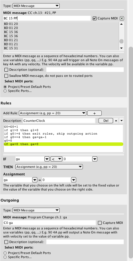

Allright, tried this one today but having some difficulties.
When I spy on the output of Bome I get a invalid message that I've never seen before, but it could be that I'm doing something wrong.
I'm not very sure what you mean with 5 steps, you mean the whole range of 127 devided by 5 or for every new CC. (0 to 4).
I think there might be something wrong with the outgoing MIDI message, what exactly does the variable ga say?
Is that just the program change?
Screen Shot 2015-03-09 at 10.20.12.png (34.91 KiB) Viewed 6707 times
Screen Shot 2015-03-09 at 10.24.09.png (66.74 KiB) Viewed 6707 times
DvlsAdvct
2015-03-09 14:24:55
Every five steps as in every five clicks of the knob, so 0-4, then 5-9, etc.
I can't see what the messages are in the first image, unfortunately. Can you screenshot the log window in MT itself?
There are two different CC messages in the Capture MIDI window you attached, BC 15 and BD 01. Are those sending when you turn one knob, or are those sending when you turn two knobs?

So I did some more testing today, still not working unfortunately.
When I use just the counterclockwise action it will send program changes according to my MIDI monitor, but when I use them both it doesn't send anything, it just sees control messages.
But even though I see the control change inside the monitor it will still not work in Ableton.
I'm probably messing up somewhere so here's the Bome Log.
edit: Yes those two different types in the MIDI learn window where from two different knobs

You're using an endless encoder, right? Does it send a standard relative message (turn it left it gives you a small range less than 3F, right it gives you a small range greater than 41) or an absolute message (0-127)?
Jorgalad
2015-03-10 14:47:52
Absolute but i can change it if necesarry
DvlsAdvct
2015-03-10 14:50:11
The problem we have is that it's Absolute. I was under the impression it was relative, cause it was an endless knob. If you switch it to endless, we should be able to figure this out.
Jorgalad
2015-03-10 19:35:45
Yes! I changed the settings to relative, and I'm getting the correct program changes now in the monitor, Ableton is still not responding though.
I've done some test and this seems to be a problem with my Ableton, the same problem persist for several different methods of sending program changes, including sending fixed messages straight from the hardware.
So I'll have to take a look at that first, thanks for the help! At least I've got the Bome part fixed now :D
